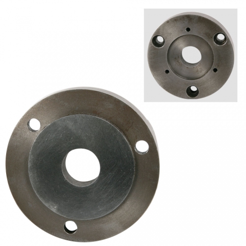

This adapter lets you mount a 4" 3-jaw lathe chuck on your mini lathe.
Use this adapter with chucks that have a 70 mm registration recess diameter such as Bison 4" 3-Jaw chucks.
The adapter mounts to the 3-hole pattern on the spindle so it works on spindles with only three holes.
Outside Diameter Ø 3.9" (100 mm)
Center Hole Ø 1.0" (25 mm)
Spindle Side Registration Recess Ø 2.2" (55 mm)
Spindle Side Bold Circle Ø 2.6" (66 mm)
Chuck Side Registration Boss Ø 2.8" (70 mm)
Chuck Side Bolt Circle Ø 3.3" (83 mm)
Chuck Mounting Holes 6
