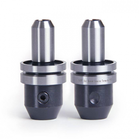

The tool holder has a set screw on one side and a balancing dimple on the other side. The balancing dimple reduces vibrations at speeds above 8000 RPM.

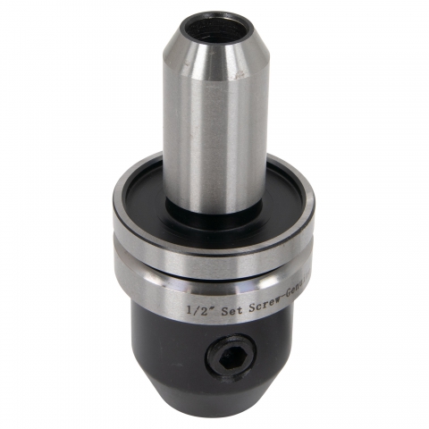

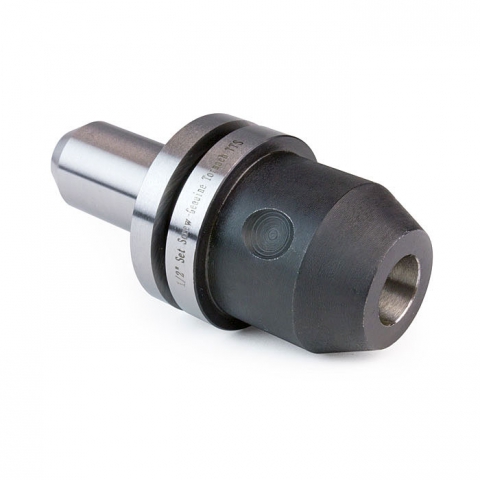

"End Mill Holder
"End Mill Holder Front and back view showing balancing dimple.
