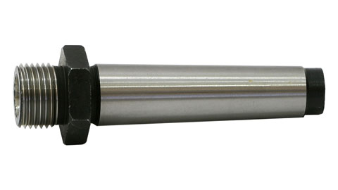

Collet Chuck, Taig Collet, 2MT, Sherline and Taig Tooling
- 3/4-16 Threaded end fits Sherline and Taig chucks and tooling
- 2MT drawbar shank with 3/8-16 drawbar thread
- Fits Taig collets and collet nut
2 Morse Taper abor with a 3/8"-16 drawbar thread. The chuck threading is 3/4"-16 and designed to fit Sherline and Taig chucks and tooling. Also fits Taig collets and collet nuts.
Note: For Sherline tooling a 1/8" thick flat washer must be used between the tool and arbor.
This product works with lathes with a 2 Morse taper spindle taper including:
- Grizzly M1015 Shop Fox 6x10 Micro Lathe
- Micro-Mark 85181 MicroLux 6x10 Micro Lathe
- SIEG C1 6x10 Micro Lathe
- Woodstock International M1015 Shop Fox 6x10 Micro Lathe
- Emco Compact 5 5x14 Lathe
- Prazi SD300 5x12 Lathe
- Craftsman & Atlas 612 6x18 Lathe
This product works with mills with a 2 Morse taper spindle taper including:
- Prazi BF400 Mill
- Prazi BF450 Mill
- Clarke CMD10 Metalworker Micro Mill
- Harbor Freight 47158 Central Machinery Micro Mill
- SIEG X1 Micro Mill
- SIEG SX1 Micro Mill
- LittleMachineShop.com 4700 HiTorque Micro Mill
- SIEG SX1P Micro Mill
- Harbor Freight 42976 Central Machinery Mill/Drill
