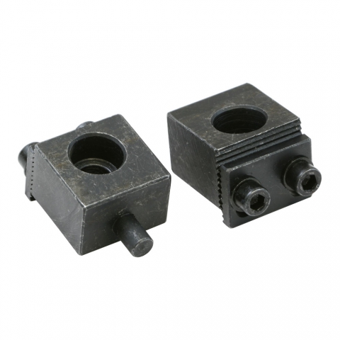

- These clamps are designed to be used with the 3" screwless vise
This pair of clamps is used to mount a screwless vise on your mill table.
You furnish 3/8" socket head cap screws of the appropriate length for your mill, and T-slot nuts.
These clamps are height-adjustable so they will work with any screwless vise with 8 mm (5/16") or larger holes. You can also use these clamps in the slots that are in the end of most screwless vises.
Chris' TipsThe adjustable foot can be rotated to provide more distance from the mill table.
To use these on a mini mill, you need two T-slot nuts and two 3/8-16 x 1.25" socket head cap screws. Your hardware store has the socket head cap screws.
