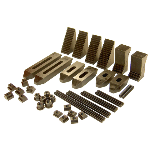

  • Six 6 mm T-slot Nuts & Six 1/4" T-Slot Nuts
  • Ten M5 Studs, Six Flange Nuts, Six Step Clamps
  • Four Step Block Pairs
  • 6 mm t-nuts suitable for Taig mills
  • 1/4" t-nuts suitable tor Sherline mills
Part Number: 2718
Weight: 2.25 lb
Price: $78.95
42-piece clamping kit.
This clamping kit fits the 6 mm T-slots on Taig mills, and the 1/4" T-slots on Sherline mills.
The clamping kit includes 10 M5 studs, 8 step blocks in pairs, 6 T-slot nuts (in each of the two sizes), 6 flange nuts, and 6 step clamps.
The stated dimension of the clamping kit is the width at the top of the T-slot.
See the Compatibility tab for machines and other products that work with this product.
Measure the width at the top of the T-slot as shown in the photo below. This is the dimension given for T-slot nuts and clamping kits. For example, if you measure 0.468 at the top of the T-slot, you should get a 7/16” (0.438”) T-slot nut or clamping kit.
