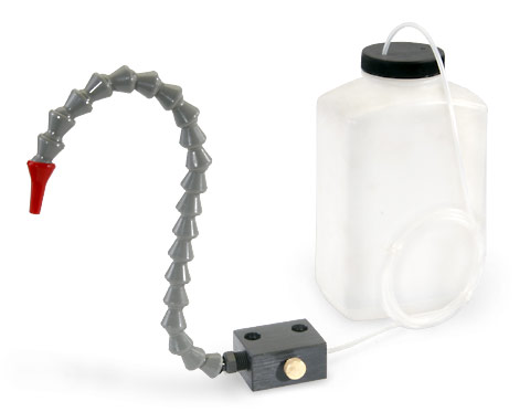

Spray Mist Unit 2725  (Discontinued)Made in United States
Spray Mist Unit
  • Sprays coolant and lubricant
  • Lock Line® snap together hose stays where you put it
Part Number: 2725  (Discontinued)
Weight: 0.53 lb
Price: $29.95
Use this spray mist unit to extend cutting tools life by keeping them cool and lubricated. The spray mist unit keeps the work piece cool with a combination of coolant mist and an air stream.
The manifold/air metering block is made from 6061 T6 aluminum. Lock Line® snap-together hose stays where you put it. The simple design protects the siphon hose from chips.
Both the air flow and the coolant flow can be adjusted separately.
Maximum air flow and coolant flow using the large ID tube is 3.5scfm of air and 1.25 gal/hr of coolant.
Minimum air flow and coolant flow using the smaller diameter tube is 0.64scfm of air and 0.025 gal/hr of coolant. This is the minimum rate to keep a consistent flow of coolant
The manifold block has 1/4 inch mounting holes for screws. It has a 1/4 NPT thread for your compressed air supply. (You furnish the air compressor.)
The spray mist unit can be pointed with one hand and the Lock Line hose stays where it is aimed. You can mount the coolant reservoir using hook and loop tape (not included).
Any coolant that is compatible with a spray mist unit will work. The choice of coolant will have more to do with the machining application than the spray mist unit. This unit is capable of spraying very precisely a small amount or a flood.
Use this on mills, drills, lathes, saws, grinders, sanders, presses, stampings.
