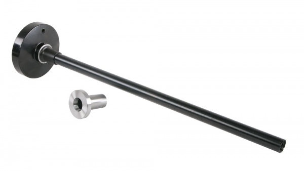

- 3C collet closer for 3MT spindle lathes
- Includes a 3 Morse taper to 3C collet adapter and a drawtube assembly
- Adapter is precision ground to minimize runout
- Drawtube is 18" long 3/4" diameter. Cut to fit most lathes with a 3 Morse taper spindle
- Great fit for all HiTorque Lathes.
3C collet closer for universally fits most lathes with a 3MT spindle.
This lathe collet closer set includes a 3 Morse taper to 3C collet adapter and a drawtube assembly.
The adapter is precision ground to minimize runout.
Drawtube allows 7/16" material to pass through.
Drawtube is 18" long and 3/4" in diameter and fits most 3 Morse taper headstocks--cut it to fit your lathe.
*Ships from factory without a handwheel handle. See related products for handle parts.
