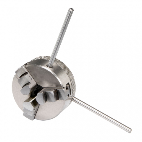

  • 3-jaw self-centering lathe chuck
  • 2" (50 mm) diameter
  • Includes reversible jaws and two tommy bars

This 2-inch 3-jaw self-centering lathe chuck fits Unimat 3 and Unimat 4 lathes.

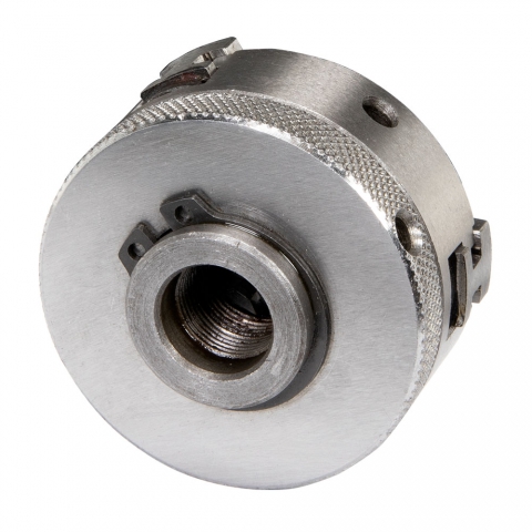

This chuck has a M14x1 threaded through hole (approximately 13 mm). It holds work up to 1.30" (33 mm) in diameter.
This chuck requires a 15 mm OD x 14 mm ID bushing to mount on a Unimat 3 or 4.
Fits the SIEG C0 lathe.
Rated Capacity, Inside Jaws 0.08" - 0.55" (2.0 mm - 14.0 mm)
Rated Capacity, Outside Jaws 0.98" - 1.30" (25.0 mm - 33.0 mm)
Diameter, Overall 1.97" (50.0 mm)
Registration Recess Diameter 0.59" (15.0 mm)
Center Hole Diameter 0.5" (13 mm)
Height 0.9" (23 mm)
Jaw Height Above Face 0.5" (12 mm)
Height with Jaws 1.4" (35 mm)
Self-Centering 3-Jaw 2 inch Lathe Chuck with adjustment rods Adjustment Rods Mounted
Self-Centering 3-Jaw 2 inch Lathe Chuck back Back View
