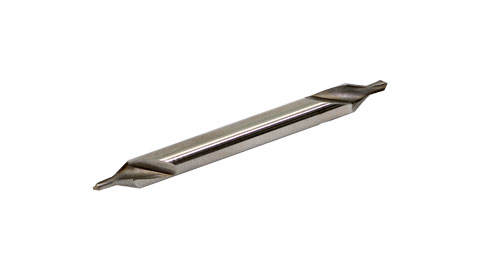

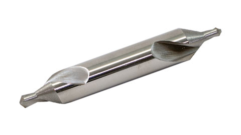

Center Drill, Number 2, HSS
  • Combined drill and countersink
  • High speed steel
  • 60° included angle
  • Right hand cutting direction
  • 3/16” body diameter, 5/64” drill diameter, and 1 7/8" overall length
Part Number: 2986
Weight: 0.01 lb
Price: $1.45
Combined drills and countersinks, commonly called center drills, are used to produce a center hole on a workpiece for turning between centers.
Center drills are also used to start drilled holes. Because they are very stiff they don't have a tendency to wander.
This center drill is made of ground high speed steel for good wear resistance with a hardness rating of Rc 58 - 60.
Combined drills and countersinks, commonly called center drills, are used to produce a center hole on a workpiece for turning between centers. Center drills are also used to start drilled holes. Because they are very stiff they don't have a tendency to wander.

Industry Standard #2
Included Angle 60°
Overall Length 1 7/8"
Body Diameter 3/16"
Drill Diameter 5/64"
Hardness Rc 58 - 60
Cutting Direction Right hand
