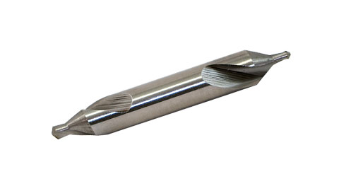

Center Drill, Number 4, HSS
  • Combined drill and countersink
  • High Speed Steel
  • 60° included angle
  • Right hand cutting direction
  • 5/16” body diameter, 1/8” drill diameter, and 2 1/8" overall length
Part Number: 2988
Weight: 0.03 lb
Price: $1.95
Combined drills and countersinks, commonly called center drills, are used to produce a center hole on a workpiece for turning between centers.
Center drills are also used to start drilled holes. Because they are very stiff they don't have a tendency to wander.
This center drill is made of ground high speed steel for good wear resistance with a hardness rating of Rc 58 - 60.
Combined drills and countersinks, commonly called center drills, are used to produce a center hole on a workpiece for turning between centers. Center drills are also used to start drilled holes. Because they are very stiff they don't have a tendency to wander.
