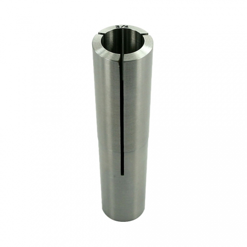

  • 11/16" Brown & Sharpe #9 taper round collet
  • 1/2"-13 drawbar thread
  • 0.0008” (0.02 mm) maximum runout
  • Overall length is 4.00"
Part Number: 3009
Weight: 0.85 lb
Price: $21.95
11/16" Brown & Sharpe #9 taper round collet to fit spindles with a Brown & Sharpe taper. This collet is made from high-grade tool steel and is precision ground and hardened. Maximum runout is 0.0008" (0.02 mm).
Drawbar thread is 1/2"-13, the width at the top is 1.067" and the width at the bottom is 0.900". Overall length is 4.00".
