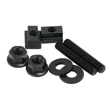

Vise Mounting Kit, 7/16" T-Slot
  • Contains the items needed to mount a milling vise on a mini mill
  • Fits 7/16" (12 mm) T-slots
  • All parts are hardened for long life
  • Includes 2 each studs, T-slot nuts, flange nuts, and hardened washers
Part Number: 3125
Weight: 0.34 lb
Price: $7.95
The studs in this vise mounting kit are 3/8"-16 x 2".
Note that you have to take the swivel base off the vise to use this kit.
The stated dimension of the clamping kit is the width at the top of the T-slot.
