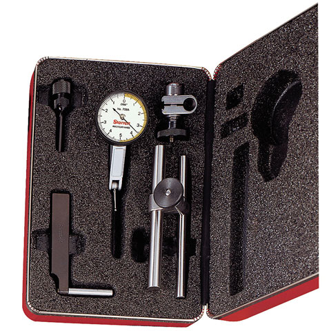

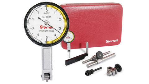

  • Starrett dial test indicator with attachments
  • Starrett catalog number 708ACZ
  • Range is 0.005" in either direction
  • Precision gear-driven design with smooth, jeweled movement
  • Dial test indicator comes in a fitted case
Part Number: 3168
Weight: 1.51 lb
Price: $592.00
These precision test indicators were designed to be positioned for easy and accurate readability. The versatility of the angled head, combined with the three dovetail mounts eliminates the need for having both vertical and horizontal style test indicators.
Includes a dovetail body clamp, tool post holder, swivel post snug with dovetail indicator clamp, and a snug and rod unit.
