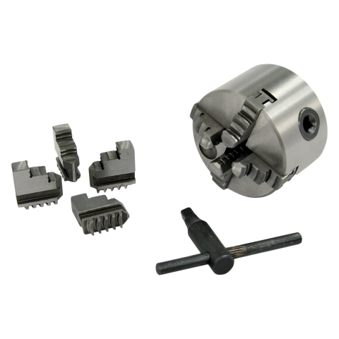

  • 4-jaw self-centering lathe chuck
  • 3" (80 mm) diameter
  • Includes chuck key, inside and outside jaws
  • Plain back mounting
  • High grade tool steel
Part Number: 3424
Weight: 4.68 lb
Price: $139.95
PayPal Credit
3 inch, 4-Jaw self-centering lathe chuck for square or octagonal work.
The through bore of this chuck is 16 mm (0.63").
The chuck can hold work up to 63 mm (2.48") in diameter.
The radial runout of a test bar held in this chuck, when the chuck is mounted true, is 0.003" maximum.
This is a fairly specialized chuck for turning square or octagonal stock.
A 4-jaw independent chuck is a lot more commonly used.
Here is a chart that provides lathe chuck capacities and mounting dimensions.
Don't forget to get a set of studs and nuts to mount this.
Rated Capacity, Inside Jaws 0.08" - 0.87" (2.0 mm - 22.0 mm)
Rated Capacity, Jamming Range 0.98" - 2.76" (25.0 mm - 70.0 mm)
Rated Capacity, Outside Jaws 0.87" - 2.48" (22.0 mm - 63.0 mm)
Runout (Max) ≤ 0.0028" (0.071 mm)
Diameter, Overall 3.15" (80.0 mm)
Registration Recess Diameter 2.17" (55.0 mm)
Registration Recess Depth 0.14" (3.5 mm)
Bolt Circle Diameter 2.60" (66.0 mm)
Center Hole Diameter 0.63" (16.0 mm)
Height 1.97" (50.0 mm)
Jaw Height Above Face 0.63" (16.0 mm)
Height with Jaws 2.60" (66.0 mm)
Number and Size of Bolts 3 M6
Chuck Key 0.31" (8.0 mm)
Max RPM 4000 RPM
Chuck Designation K12-80
