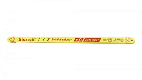

  • Starrett bi-metal unique HSS Safe-Flex hacksaw blade
  • 12" X 1/2" X .025" (300mm X 13mm X 0.65mm)
  • 32 TPI (Teeth per Inch)
  • Starrett catalog number BS1232
  • Sold Individually
Part Number: 3561
Weight: 0.04 lb
Price: $2.95
This blade is 12" long, 1/2" wide and has 32 teeth per inch. The blade is 0.025" thick.
bi-metal unique high speed steel Safe-Flex hacksaw blades are made with a patented solid-state diffusion process with 170% more HSS weld area and ground teeth for reduced blade fracture, faster cutting and longer life.
