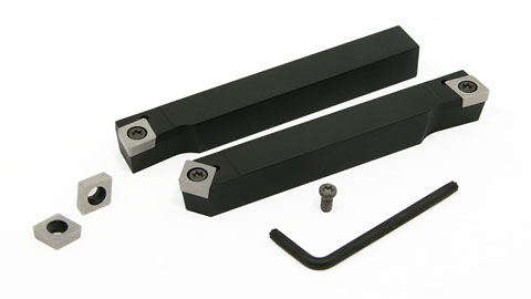

  • Right hand tool holder
  • Left hand tool holder, double ended
  • Includes five T-15 HSS (CCMW32.52) inserts
  • Includes four MS-1155 screws and one T-15 wrench
Part Number: 3569
Weight: 0.95 lb
Price: $164.95
PayPal Credit
Right hand bar has 0.5" shank and is 4" long.
Left hand bar has 0.5" shank and is 4" long. It includes a second insert pocket that provides a 50° side cutting edge.
Uses CCMW32.51 and CCMW32.52 inserts.
The second insert pocket on the left hand tool provides a way to use the second and fourth corners on the diamond insert.
