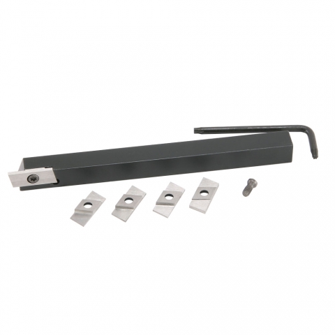

  • For external grooving and cut-off operations
  • Includes two 1/16" (.062") groover T-15 high speed steel inserts
  • Includes two 1/32" (.031") groover T-15 high speed steel inserts
  • Includes one 1/64" (.016") groover T-15 high speed steel insert
  • This lathe grooving tool includes two IS 3007 screws and one T-9 wrench
Part Number: 3572
Weight: 0.59 lb
Price: $149.95
PayPal Credit
This Arthur R. Warner Co. indexable cut-off and grooving tool has a 0.375" shank and is 4.5" long.
The maximum cutting depth of the groover inserts is approximately 0.25".
