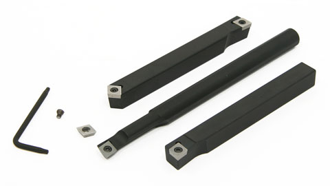

Turning & Boring Tools, 3/8" Indexable, 3 Piece Set, A R Warner
- Right and left hand turning tools with 0.375" shank 3.5" long
- Boring bar with 0.375" shank 5.0" overall length
- Includes three T-15 HSS (CCMW21.51) inserts for turning
- Includes two T-15 HSS (CEMW21.51) inserts for boring
- Includes two MS-1152S screws, three MS-1153 screws and one T-7 wrench
This Arthur R. Warner Co. kit includes a 3/8" right-hand turning tool, a 3/8" left-hand turning tool, and a 3/8" boring bar. The right hand turning bar has a 0.375" shank, and is 3.50" in overall length.The left hand turning bar has a 0.375" shank, and is 3.50" in overall length. The left hand turning bar has a second insert pocket in opposite end that provides a 50° side cutting edge angle. This provides a way to use the two insert points that are not used in the other tool holders. The boring bar has a 0.375" shank, and is 5.0" in overall length. It has 0.188" flat along length for location, and requires a 0.365" minimum bore. The Arthur R. Warner Co. is a family-owned American manufacturer of high speed steel products with specialization in cutting, shaping, pre-grinding, heat treating, and finish grinding of premium grades of flat high speed steel. Their quality is excellent and LittleMachineShop.com is proud to carry their products.
