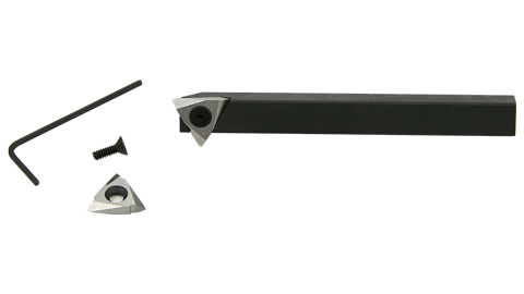

  • For external threading, 8 through 36 TPI
  • 3/8" shank, 3/8" IC Inserts, 5" long
  • 2 HSS inserts included: TNMC-32-NV and TPMC-32-NV
  • 1 extra 4-40 flat head cap screw
  • 1 - 1/16" Allen wrench

This Arthur R. Warner Co. precision threading tool will turn external threads. The tool can turn from 8 through 36 pitch, 60 degree threads.

This tool ships with two kinds of inserts. The TPMC-32-NV insert is better in stainless and the TNMC-32-NV is better in alloy steels. You can use either for internal and external threading.
The difference is the relief angle. TPMC inserts have an 11 degree relief angle. TNMC insertsĀ have a 0 degree relief angle.
