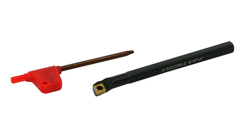

Boring Bar, 5/16" Indexable
  • Profiling bars for semi-finishing and finishing operations
  • Designed for CCMT 80° inserts
  • 7° Relief angle
  • Negative 5° Lead angle for boring
  • 3° Side & end cutting edge angle
Part Number: 3719
Weight: 0.11 lb
Price: $39.95
This 5/16" diameter indexable boring bar uses CCMT inserts.
The boring bar is 4" long.
The minimum boring diameter is 0.437".
Use CCMT 21.51 or CCMT 21.52 inserts with this boring bar.
This boring bar does not come with an insert. You must purchase inserts separately.
Overall Length 4" (102 mm)
Diameter 0.312" (7.94 mm)
Minimum Bore 0.437" (11.10 mm)
CCMT Inserts 80°
Replacement Inserts CCMT-21.51 or CCMT-21.52
Relief Angle
Lead Angle for Boring -5°
Side & End Cutting Edge Angle
Screw M2.5x8
Torx Wrench T-8
