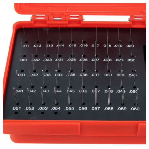

  • 50 2" long pin gages
  • Each pin is up to 0.0002" under the marked size
  • Hardened to 60-62 Rc
  • Finished to 10 microinches
  • Furnished in a sturdy plastic case with sizes marked
Part Number: 3879
Weight: 0.66 lb
Price: $46.95
Fifty 2" long pin gages in sturdy storage case. These pin gages provide one of the best ways of measuring hole diameters. They can also be used to measure the distance between holes and for go/no go gaging.
This set includes 50 pin gages, one for each 0.001" from 0.011" to 0.060". Each of the pin gages are individually marked with their respective sizes and each set comes with a reference sheet showing the sizes of each pin. The pin size tolerances are with -0.0002" to +0.0000" of their marked size and finished to 10 micro-inches.
Pins are hardened to 60-62 Rc.
"Pin Gage Set Detail View
