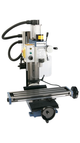

HiTorque Mini Mill, Tilting Column 3900 (Discontinued)
- Most powerful mill in its class & most low-speed torque in its class
- No gears in spindle drive
- Largest table and X-Y travel in its class
- R8 spindle (Includes R8 to 33JT drill chuck arbor, but no drill chuck)
Weight: 171 lb
Price: $849.95
Chris' Tips- 500 Watt output spindle motor
- Large X-Y table
- R8 Spindle for wide tool availability
- Column tilts 45° either side of vertical
- Dovetail column maintains head alignment at any height
- Fine feed on Z-axis for precise control
- Three radial handles for drilling
- E-stop safety power switch
- Adjustable Z-axis stop for repetitive drilling
- Neoprene bellows protect horizontal ways
- Adjustable gibs on all dovetail ways
- Includes R8 to 33JT drill chuck arbor (no drill chuck)
