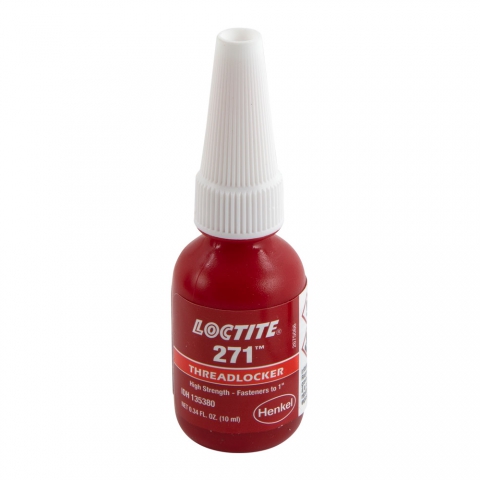

Loctite 271 High Strength Red ThreadlockerMade in United States
  • For up to 1" dia. fasteners. Ideal for harsh applications and tamperproofing. UL listed
  • 10 ml bottle
Part Number: 3988
Weight: 0.05 lb
Price: $22.95
Loctite® 271™ High Strength, Low Viscosity Red Threadlocker for fasteners up to 1" (25 mm) in diameter.
LOCTITE® 271™ is designed for the permanent locking and sealing of threaded fasteners. The product cures when confined in the absence of air between close fitting metal surfaces and prevents loosening and leakage from shock and vibration. Typical applications include the locking and sealing of large bolts and studs (up to M25 ).
