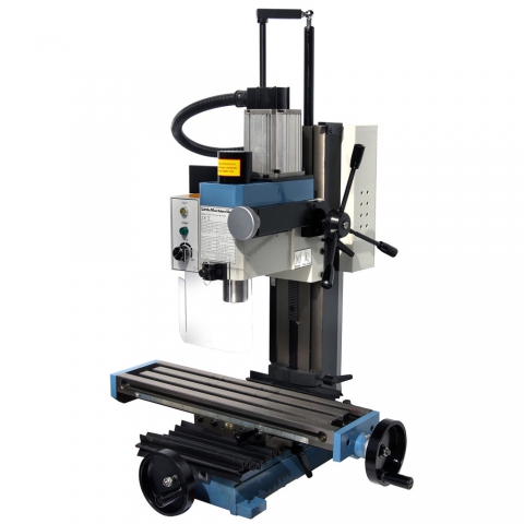

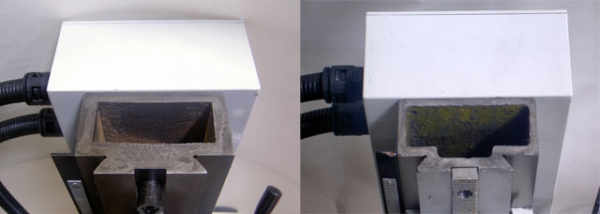

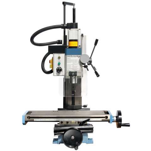

This mill has a solid column. It does not tilt from side to side. This construction is significantly stiffer than the tilting column on other mini mills. This model also includes the air spring head support for even support through the Z-axis range of travel.
The 500 Watt brushless spindle drive motor provides tremendous low-end torque. And you can vary the speed from 100 rpm to 2500 RPM continuously. There are no gears to shift. And, with no gears, the HiTorque Mini Mill machine is the quietest in its class.
The large mill table provides 50% more table area than other mini mills. It also has 30% more travel in each direction. The resettable feed dials allow you to zero them at any point.
The HiTorque Mini Mill has drill press handles for drilling and fast motion of the mill's head. It also has Z-axis fine feed with 0.001" resolution for milling operations.
This machine is shipped completely assembled and adjusted. Machined surfaces are coated with a viscous oil to prevent rust. It wipes off easily with a rag; no solvents necessary.

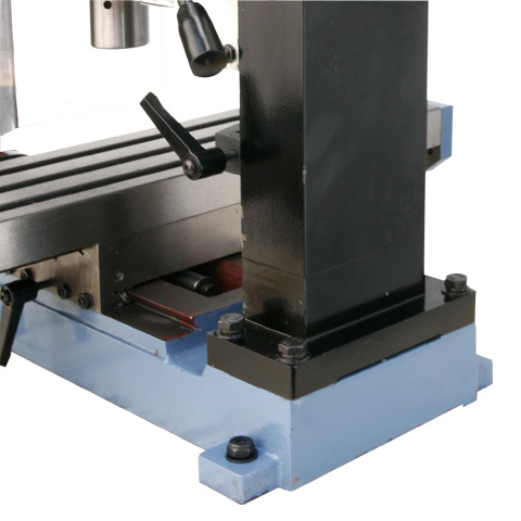

- Solid column that does not tilt

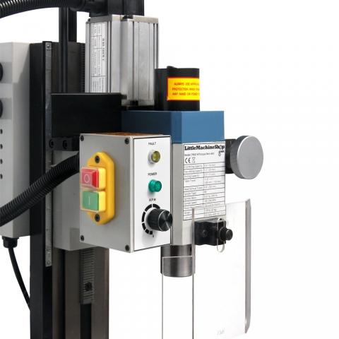

- E-stop safety power switch

3990 HiTorque Mini Mill |

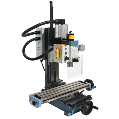

Front View |
Side View |
Control Box |

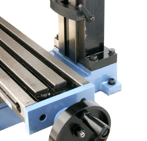

Solid Column Rigid Base |
Back View Solid Column Rigid Base |
The solid column on the left, tilting column on the right. The solid column has significantly thicker walls |
