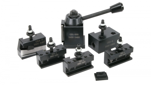

  • Fits Atlas/Craftsman 6" lathes
  • 0XA, or series 000 size (60% of AXA size)
  • Includes five tool holders
  • All steel construction
  • Includes T-slot nut for most Atlas/Craftsman 6" lathes
Part Number: 4058
Weight: 4.51 lb
Price: $195.95
PayPal Credit
All-steel, wedge type quick change tool post set for Atlas/Craftsman 6" lathes.
It is the perfect size for bench lathes. The tool holders have been designed specifically to work on lathes that have limited distance from the top of the compound to the center of the lathe. This tool post mounts with a T-slot nut, which is included.
All working parts are hardened and ground. It is completely sealed for maintenance-free operation.
This set includes the tool post and the following tool holders:
2 - #1 Turning & Facing
1 - #2 Boring, Turning & Facing
1 - #4 Heavy Duty Boring will hold both 3/8 and 1/2 boring bars
1 - #7 Universal Parting Blade (for 1/2 inch cut-off blade - 4 degree)
*Note* The t-slot nut provided with this post fits most 6" Atlas and Craftsman lathes to the best of our knowledge, but we have come across a few instances where it was not the right size. Included on the bottom of the QCTP is a threaded blank that can be milled to fit a variety of slots.
This QCTP is not a good fit for the mini lathe. It requires about 3/4" from the top of the compound to the centerline of the lathe. Get the 3112 QCTP instead.
This QCTP is great for most lathes up to 9" swing.
The 0XA quick change tool post and the associated tool holders were developed by Tormach and LittleMachineShop.com in cooperation.
See the comparison chart of the quick change tool post sets we carry.
The two 0XA tool posts (3112 and 3048) are the same except for the cut-off tool holder.
The 3112 has a cut-off tool holder that mounts the blade horizontally. Thus it can be used on lathes that have only 5/8” from the top of the compound to the centerline of the lathe, like the 7x mini lathes.
The 3048 has a cut-off tool holder that mounts the blade at a 4 degree angle. It needs ¾” from the top of the compound to the centerline because of the angled cut off blade.
