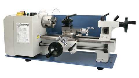

  • Most powerful lathe in its class
  • Most low-speed torque in its class
  • No gears in spindle drive
  • Cam lock tailstock
Part Number: 4100  (Discontinued)
Weight: 118 lb
Price: $809.95
The LittleMachineShop.com HiTorque Mini Lathe is the best in its class. It has the most power, most torque, and a longer center distance than other lathes in its class.
The 500 Watt brushless spindle drive motor provides tremendous low-end torque. And you can vary the speed from 50 rpm to 2500 rpm continuously in both directions. There are no gears to shift.
The cross feed and compound rest dials are graduated in 0.001" and 0.025 mm. The lathe is equipped with a 4-way indexing tool post set for 5/16" (8 mm) tools.
Real top and bottom half-nuts and a reversible 16 TPI lead screw provide extended threading capability. You can create every American Standard Unified class 2A inch screw thread from 4 to 80 threads per inch, and you can create every American Standard Metric class 6h thread from 0.3 to 8 mm pitch with the extra 21 tooth change gear that is included.
The lathe includes a chip tray, a backsplash guard, and spreaders to give the feet a broader stance.
The LittleMachineShop.com model 4100 HiTorque Mini Lathe is a version of the SIEG SC2.

  • Mini Lathe Users Guide written by Chris Wood
  • E-stop safety power switch
  • Zero-settable hand wheels graduated in 0.001" on cross slide and compound rest
  • Extended threading capability - inch and metric threads
  • Rear apron shield to keep swarf out of the mechanism
  • Four-way tool post
  • Reversible lead screw for right and left hand threads
Swing Over Bed 7" (180 mm)
Swing Over Saddle 4.3" (110 mm)
Distance Between Centers 12.2" (310 mm)
Spindle Through Hole 0.8" (20 mm)
Spindle Motor Output 0.7 hp (500 Watts)
Range of Threads 4-80 TPI (0.3-8 mm)
Spindle Taper #3 Morse taper
Tailstock Taper #2 Morse taper
Spindle Speed 50 - 2500 RPM
Cross Slide Travel 2.6" (65 mm)
Crated Weight 103 lbs (47 kg)
Machine Weight 82 lbs (37 kg)
Overall Dimensions (W x D x H) 27" x 10" x 12" (685 mm x 260 mm x 300 mm)
Crate Dimensions (W x D x H) 30" x 16" x 15" (770 mm x 410 mm x 380 mm)
The HiTorque Mini Lathe comes with the following:
  • 3" (80 mm) 3-jaw self centering lathe chuck with two sets of jaws and a chuck wrench
  • A Morse taper #2 dead center for the tailstock
  • An 11-gear change gear set that includes a 21 tooth gear for accurate metric threading
  • Two open end wrenches
  • Four hex (Allen) wrenches
  • A plastic oil can
