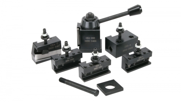

Quick Change Tool Post Set, 0XA for G0768
- Fits Grizzly G0768 lathe
- 0XA, or series 000 size (60% of AXA size)
- Includes five tool holders
- All steel construction
- Includes mounting stud and spacer for G0768 lathe
Weight: 4.68 lb
Price: $199.95
Estimated availability:
31-Jan-2026
It is the perfect size for bench lathes. The tool holders have been designed specifically to work on lathes that have limited distance from the top of the compound to the center of the lathe. This tool post mounts on a spacer with a threaded adapter stud, which is included.
All working parts are hardened and ground. It is completely sealed for maintenance-free operation.
This set includes the tool post and the following tool holders:
2 - #1 Turning & Facing
1 - #2 Boring, Turning & Facing
1 - #4 Heavy Duty Boring will hold both 3/8 and 1/2 boring bars
1 - #7 Universal Parting Blade (for 1/2 inch cut-off blade - 4 degree)
Grooving & Cut-Off Tool, 3/8" Shank, HSS Blade, A R Warner Kit #28
Cut-Off Blade, P1
