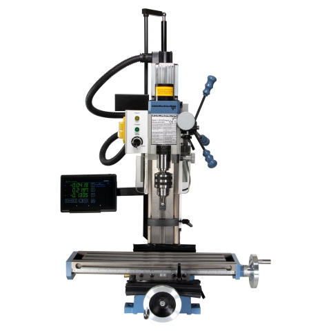

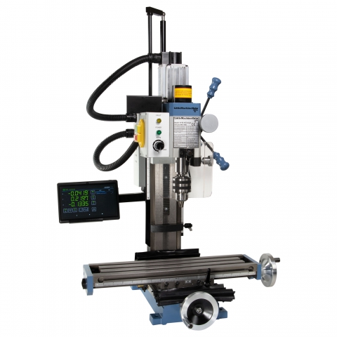

The Model 4190 Deluxe HiTorque Mini Mill has all the features of our popular Model 3990 HiTorque Mini Mill, plus:
* 3-axis digital readout (DRO) with Bluetooth and 7" tablet display. The DRO is completely installed on the mill.

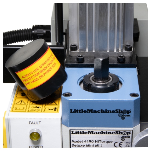

* Electrically interlocked spindle lock
* Machined aluminum handwheels and color keyed drill handles

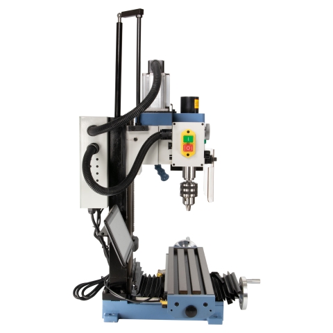

The LittleMachineShop.com HiTorque Mini Mill for sale is the best in its class. It has the most power, most torque, and a larger table than other mills in its class.

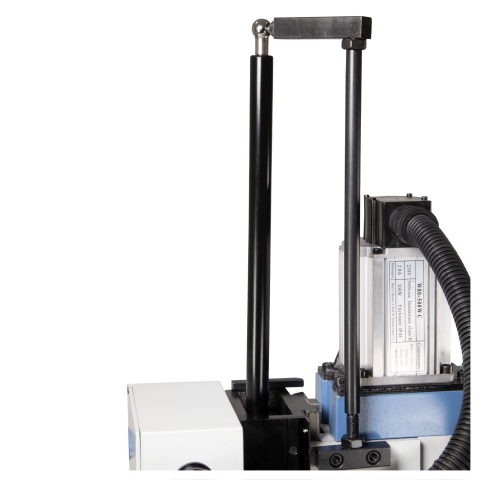

This mini milling machine has a solid column. It does not tilt from side to side. This construction is significantly stiffer than the tilting column on other mini mills. This model also includes the air spring head support for even support through the Z-axis range of travel.
The 500 Watt brushless spindle drive motor provides tremendous low-end torque. And you can vary the speed from 100 rpm to 2500 rpm continuously. There are no gears to shift. And, with no gears, the HiTorque Mini Mill is the quietest in its class.
The large mill table provides 50% more table area than other mini mills. It also has 30% more travel in each direction. The resettable feed dials allow you to zero them at any point.
The HiTorque mini milling machine for sale has drill press handles for drilling and fast motion of the mill's head. It also has Z-axis fine feed with 0.001" resolution for milling operations.

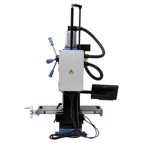

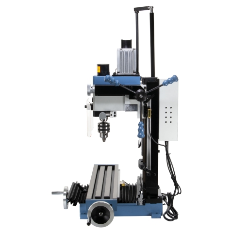

HiTorque Deluxe Solid Column Mini Mill 4190 mini mill - alternate view
Front View - HiTorque Deluxe Solid Column Mini Mill Front view
Side View - HiTorque Deluxe Solid Column Mini Mill Side view
Rear View - HiTorque Deluxe Solid Column Mini Mill Rear view
R8 Spindle - HiTorque Deluxe Solid Column Mini Mill R8 spindle
Electrically interlocked spindle lock disengaged - HiTorque Deluxe Solid Column Mini Mill Electrically interlocked spindle lock - Disengaged
Electrically interlocked spindle lock engaged - HiTorque Deluxe Solid Column Mini Mill Electrically interlocked spindle lock - Engaged

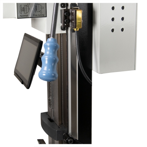

Z-Axis handle - HiTorque Deluxe Solid Column Mini Mill Z-Axis handle
Z-Axis handle lock disengaged - HiTorque Deluxe Solid Column Mini Mill Z-Axis handle lock disengaged

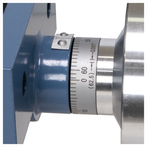

Z-Axis fine feed - HiTorque Deluxe Solid Column Mini Mill Z-Axis fine feed

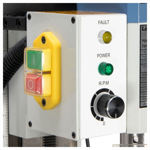

Control Box - HiTorque Deluxe Solid Column Mini Mill Control box

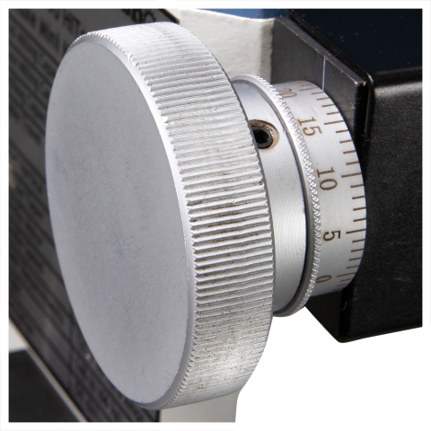

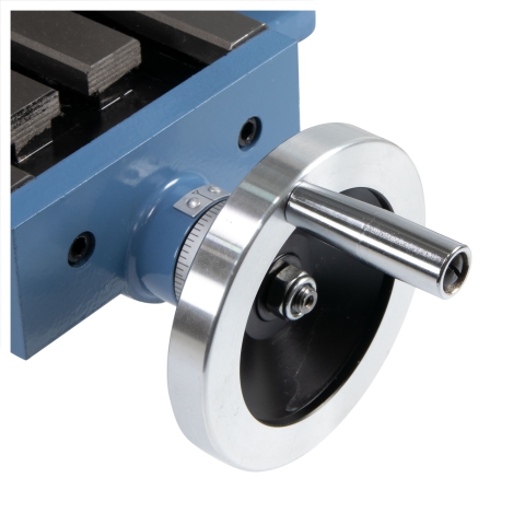

Anodized aluminum hand wheels - HiTorque Deluxe Solid Column Mini Mill Anodized aluminum hand wheels
X-Axis Scale Ring - HiTorque Deluxe Solid Column Mini Mill X-Axis scale ring
Air Spring - HiTorque Deluxe Solid Column Mini Mill Air spring

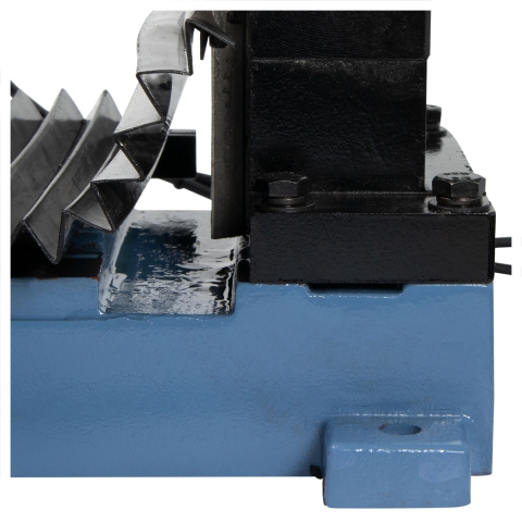

Solid column base - HiTorque Deluxe Solid Column Mini Mill Solid column base
