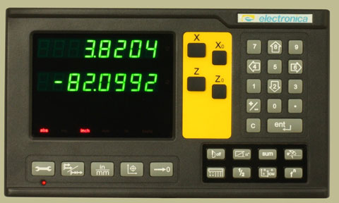

Digital Position Readout, 2-Axis Magnetic Scale, DRO Pros Lathe 4241 (Discontinued)
- Magnetic scales can be cut to exact length you need
- Easy to use. More buttons, most intuitive layout--just walk up and operate
- 5 micron (0.0002") resolution for Z-axis, 1 micron (0.00004") for X-axis
- Clearly-written full-color manual and Lifetime warranty

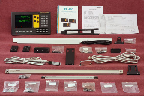

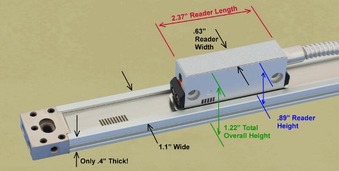

Magnetic scales are impervious to liquid yet they are slimmer than glass scales. They’re easier to mount and more durable than other scales. Simply cut the scales to the length you need and mount them. See the instructions on the Chris’ Tips tab.
This package includes these features: half function, inch/metric conversion, absolute/incremental modes, axis home reference, machine reference, sub datums, tool offsets, taper calculator, internal axis summing, vectoring function, calculator (trigonometric), encoder fail detection, memory backup.
Operates on 120V or 240V AC

| Repeatability | 10 microns |
| Resolution | 5 microns |
| Resolution (Cross Slide) | 1 micron |
| Specified Accuracy | 15 microns / 1 m travel |
| Accuracy / Foot | 0.0002" (0.005 mm) |
| Accuracy / 100 Mm | 0.0001" (0.002 mm) |
| Scales Cut to Length by User | Yes |
| Scale Technology | Magnetic |
| Scale Protection | Coolant & dust proof to IP67 |
