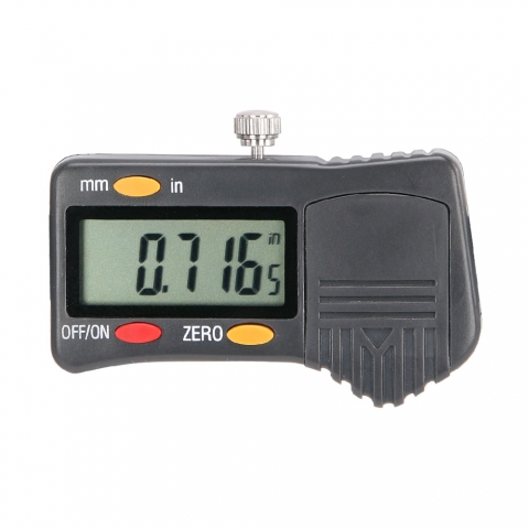

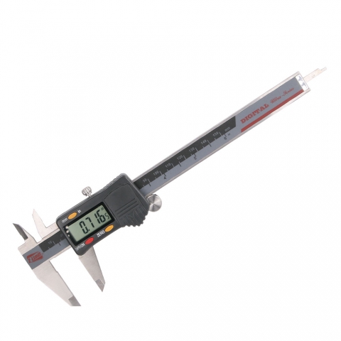

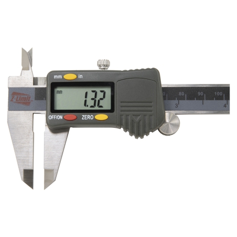

  • Dasqua 6" metal housing digital caliper
  • Large, easy-to-read LCD display can be zeroed at any position
  • Hardened stainless steel body for long life, with fine adjustment thumb wheel
  • Resolution is 0.0005" (0.01mm) and linear accuracy meets DIN 862 standard
  • Accuracy is 0.001" (0.02mm)
Part Number: 4251
Weight: 1.05 lb
Price: $64.95

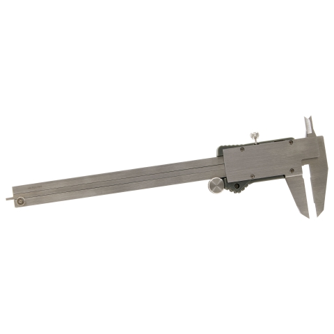

This Dasqua 6" electronic digital caliper has a stainless steel metal housing and is made in strict accordance with DIN862 (standards for caliper accuracy).
The 6" digital caliper measures four ways; outside, inside, depth, and step. The three keys are on/off, inch/mm, and zero.
Jaw Depths: Inside 1.58 (40mm), Outside, 0.61" (5/8") (15.5mm) .

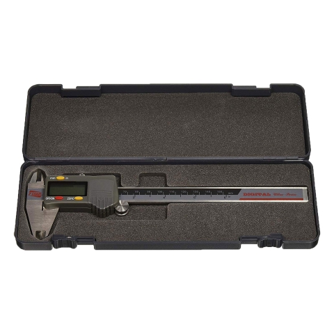

The CR-2032 battery is included. Includes a durable plastic case.
