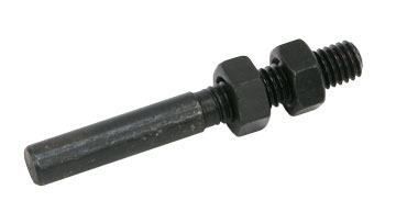

Driver, Lathe Dog, M6
  • Lathe Dog Driving Pin
  • For mini lathes with 80 mm (3") chuck mounting flanges
  • Fits M6 mounting holes
Part Number: 4476
Weight: 0.03 lb
Price: $2.95
M6 lathe dog driver acts as a holding pin when using a lathe dog that has a straight tail. Bolt into 80 mm (3") faceplates that have M6 mounting holes.
The photo shows how to use a lathe dog and drive pin with the mini lathe.
