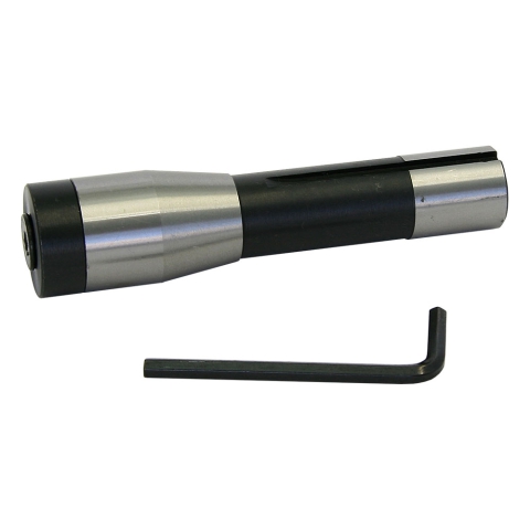

Slitting Saw Arbor, R8 Shank
- For saw blades up to 3/16" thick
- Fits 1/2", 5/8", 3/4", 7/8", and 1" holed slitting saw blades
- R8 Shank
- Overall length is 5-3/32"
- Drawbar end is 7/16"-20
Part Number: 4647
Weight: 1.09 lb
Weight: 1.09 lb
Price: $29.95
Estimated availability:
Unknown
This arbor has an R8 shank and fits slitting saw blades up to 3/16" thick. This slitting saw arbor is compatible with blades that have a center hole of 1/2", 5/8", 3/4", 7/8", or 1".
Includes a 3/16 hex key.
