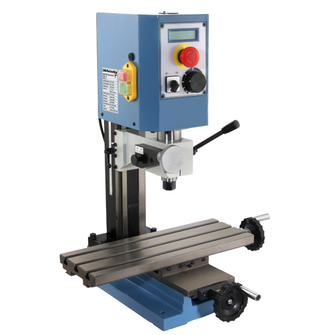

"HiTorque Micro Mill Side View
"HiTorque Micro Mill Alternate Side View
"HiTorque Micro Mill Front View
"HiTorque Micro Mill Headstock
"HiTorque Micro Mill Handwheel
"HiTorque Micro Mill Z-axis Lock Lever
"HiTorque Micro Mill Z-axis Depth Stop
"HiTorque Micro Mill zZ-axis Fine Feed
"HiTorque Micro Mill Z-axis Fine Feed Disengaged
"HiTorque Micro Mill Z-axis Fine Feed Engaged
