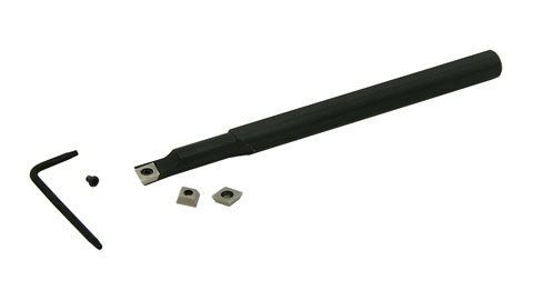

Boring Bar, 3/8" Indexable, 80 Deg HSS Diamond Inserts, A R Warner Kit #13Made in United States
  • 3/8" diameter, 5" long boring bar
  • 3 CEMW-21.5.5 high speed steel inserts
  • 1 extra Torx screw
  • 1 wrench
Part Number: 4788
Weight: 0.53 lb
Price: $124.95
PayPal Credit
This Arthur R. Warner Co. precision boring bar uses high speed steel inserts. Combine the advantages of high speed steel cutting tools with the convenience of indexable tooling.
The minimum boring diameter is 0.330".

Overall Length 5.0" (127 mm)
Minimum Bore .330
Lead Angle
Insert Relief 20°
IC 0.250" (6.35 mm)
Insert Thickness 0.093" (2.36 mm)
Insert Hole 0.110" (2.79 mm)
Insert Top Opening 0.146" (3.71 mm)
Insert Radius 0.008" (0.20 mm)
Screws CO-2205 S
Wrench T-7
