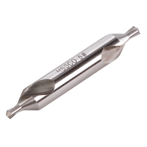

  • Combined drill and countersink
  • M42 (8% cobalt) high speed steel
  • 60° included angle
  • Right hand cutting direction
  • 7/16" body diameter, 3/16" drill diameter, and 2 3/4" overall length
Part Number: 4868
Weight: 0.08 lb
Price: $9.95

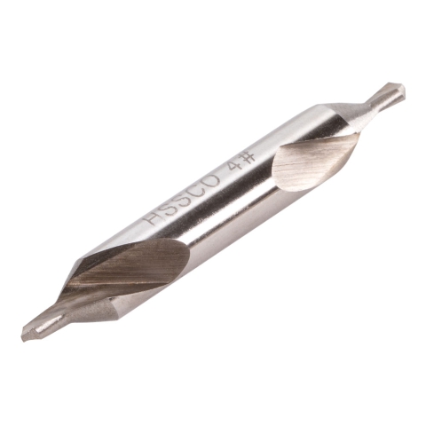

Combined drills and countersinks, commonly called center drills, are used to produce a center hole on a workpiece for turning between centers.
Center drills are also used to start drilled holes. Because they are very stiff they don't have a tendency to wander.
This center drill is made of ground high speed M42 cobalt steel for good wear resistance.
Combined drills and countersinks, commonly called center drills, are used to produce a center hole on a workpiece for turning between centers. Center drills are also used to start drilled holes. Because they are very stiff they don't have a tendency to wander.
