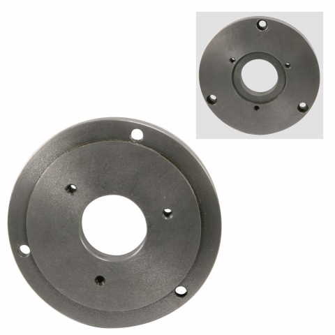

Adapter, 6" Lathe Chuck
- Fits 6" 3-Jaw Lathe Chucks with 130 mm Registration Recess
- Can Use with 6" Chuck on a Flange for 4" Chuck with 72 mm Registration Boss
- Works on 8x12 and 8x14 Lathes
Part Number: 4912
Weight: 5.12 lb
Weight: 5.12 lb
Price: $29.95
Estimated availability:
31-Jan-2026
This adapter mounts a 6" 3-jaw lathe chuck with a 130 mm registration recess on a flange for a 4" chuck with a 72 mm registration boss. It works on 8x12 and 8x14 lathes as well as the Harbor Freight 5980 multipurpose machine. It also fits the SIEG C4 and SC4 lathes.
*NOTE* If using with any of our 6" 4-jaw chucks (2038, 6547) additional mounting holes will need to be drilled. Use M8 transfer screws to mark holes for the 2038 chuck.
| Outside Diameter | Ø 6.5" (165 mm) |
| Center Hole | Ø 2.0" (50 mm) |
| Spindle Side Registration Recess | Ø 2.8" (72 mm) |
| Spindle Side Bolt Circle | Ø 3.3" (84 mm) |
| Chuck Side Registration Boss | Ø 5.1" (130 mm) |
| Chuck Side Bolt Circle | Ø 5.6" (142 mm) |
| Chuck Mounting Holes | 3 |
