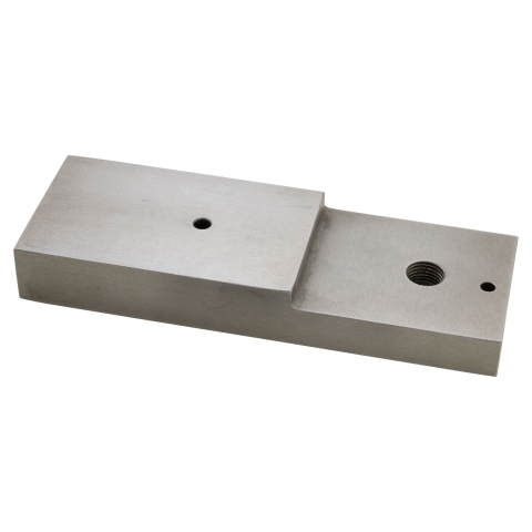

This is the compound rest top that comes equipped on the HiTorque Deluxe bench lathes. See Used On tab for reference to machines using this part and the corresponding drawing number.
This compound rest top is specially modified to mount the AXA quick change tool post on a HiTorque 8.5x16 or 8.5x20 Bench Lathe or a SIEG C4 or SC4 lathe. The threading is 9/16-18 to support an AXA quick change tool post.
If replacing a bench lathe standard tool post with an AXA QCTP, see the compatibility tab for reference to machines that are compatible with this product.
*NOTE: If you have a newer 9x20 HiTorque Bench Lathe please order part 6573 (http://lmscnc.com/6573)
Length 6.69" (170.0 mm)
Width 2.36" (60.0 mm)
Tall Section Length 3.94" (100.0 mm)
Narrow Section For Tool Post - Length 2.76" (70.0 mm)
Tall Section Height 0.94" (24.0 mm)
Narrow Section For Tool Post - Height 0.67" (17.0 mm)
Threaded Hole 9/16"-18

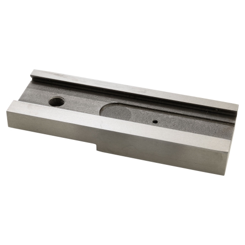

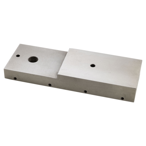

"Compound Rest Top Reverse view
"Compound Rest Top Bottom view
