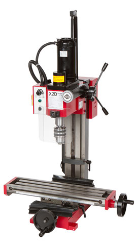

The SIEG X2D Mini Mill has all the features you want at an incredibly low price.

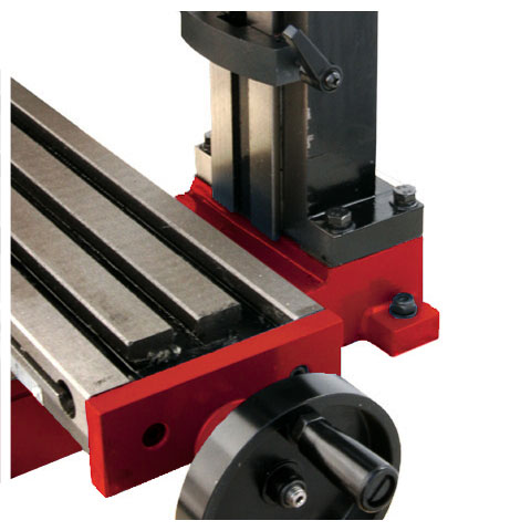

This mill has a solid column. It does not tilt from side to side. This construction is significantly stiffer than the tilting column on other mini mills.

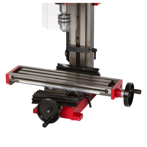

The large mill table provides 50% more table area than other mini mills. It also has 30% more travel in each direction. The resettable feed dials allow you to zero them at any point.

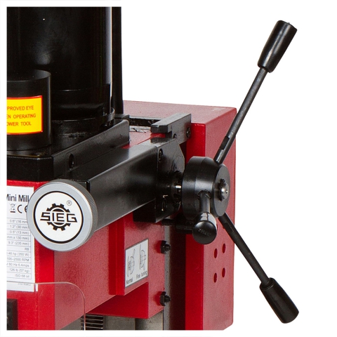

The SIEG X2D Mini Mill has drill press handles for drilling and fast motion of the mill's head. It also has Z-axis fine feed with 0.001" resolution for milling operations.
This model also includes the air spring head support for even support throughout the Z-axis travel.

The solid column is much more rigid than the tilting column.
Some people may feel that the tilting column is a feature, but I have used a mini mill for many years and never tilted the column on purpose.

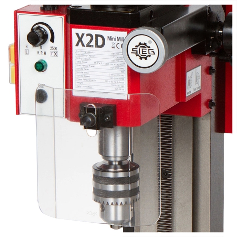

  • 350 Watt output spindle motor
  • 2-Speed ranges for low speed torque
