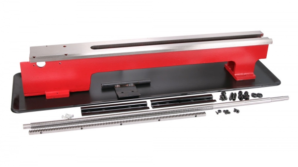

Bed Extension Kit 16", Mini Lathes
- Precision ways are approximately 28-3/8" long
- Rack is approximately 17-3/4" long
- Lead screw is approximately 29-5/16" long
- PLEASE CHECK COMPATABILITY BEFORE ORDERING
This lathe bed extension kit turns your 7x10, 7x12, or 7x14 lathe into a 7x16 lathe. This lathe conversion kit includes a bed casting, a lead screw, a rack, a motor mount, a chip pan, 2 chip pan braces, several fasteners, and complete instructions.
The 7x16 bed is actually 8" longer than the 7x10 bed. It is 4" longer than the 7x12 bed.
This is NOT a bolt-together kit. You must drill and tap 9 holes in the new bed casting to match your lathe. You need three metric taps: M3x0.5, M6x1, and M8x1.25. If you don't have metric drills, you can use letter and number drills for tap drills. (The sizes are given in the instructions.)
