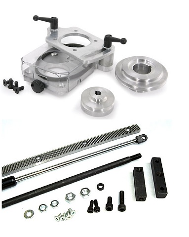

Upgrade Kit, Mini Mill
- Includes 2258 Air Spring Kit and 2560 Mini Mill Belt Drive Kit
- Much quieter operation
- Spindle speed up to 4300 RPM
- Allows travel to the top of the column while providing better support for the mill head
- No more broken drive gears
This mini mill kit provides an easy-to-install alternative to the noisy and fragile factory-installed gears that drive the spindle on the machine. The kit includes one belt. Change speeds without any tools. Simply remove the guard, loosen the lever locks and move the belt from one pair of pulleys to the other. Low speed range is 0-1700 RPM. High speed range is 0-4300 RPM.
The small pulley has a 9 mm bore with a 3 mm keyway. The large pulley has a 30 mm bore with a 5 mm keyway. If your shafts don't match these values, then this belt drive will not fit your mill.
Convert torsion spring mini mills to air spring. This mini mill kit provides all the parts required to change to a vertical air spring that mounts inside and above the column. With the air spring installed, you can move the mill head up until the top of the casting is almost flush with the top of the column. You can move it down until it almost contacts the adjustable Z-axis stop set in its lowest position. This air spring has about 35 pounds of force. This is not enough to totally support the head, but it is a heck of a lot more support than the torsion arm provides.
