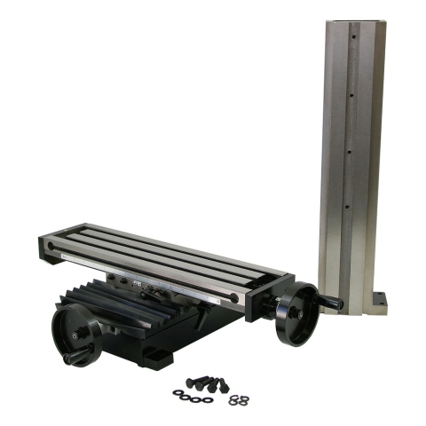

Large Table Solid Column Conversion Kit, Mini Mill
- Converts a tilting column mini mill to the large table solid column version
- 30% more travel in both directions
- 50% more table area
- Solid column is significantly more rigid
Weight: 105 lb
Price: $619.95
Estimated availability:
31-Jan-2026
The kit includes the X-Y table and column from the HiTorque Solid Column Mini Mill (part number 3990), the fasteners needed to connect them.
This kit contains a complete X-Y table assembly for a mini mill.
The table is 120 mm (4.73") by 460 mm (18.11"). It has three 12 mm T-slots.
The X-axis travel is 300 mm (11.8") and the Y-axis travel is 130 mm (5.1").
The dials are graduated in 0.001" and one turn of the hand wheels moves the table 0.050".
The X-Y table is made of cast iron and steel. There are adjustable gibs on both axes.
