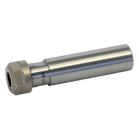

  • 5/8" x 2 1/2" shank ER-11 collet chuck
  • Made of 20CrMnTi alloy steel
  • Max runout is 0.0003"
  • Balanced to 18,000 RPM
  • Electrolysis nickle coating
Part Number: 5188
Weight: 0.20 lb
Price: $79.95
Collet Chuck, ER-11, Straight Shank, Professional Grade
This ER-11 collet chuck straight shank tool holder is a great tool for supporting small end mills and engravers. It is made of 20CrMnTi alloy steel and is balanced to 18,000 RPM. The maximum runout is 0.0003" (0.0076 mm).
ER-11 collets have a range of 1/32" to 1/4" (0.5 to 7.0 mm). The overall length is 3.457" (88 mm) and the width at the nut is 0.748" (19 mm).
