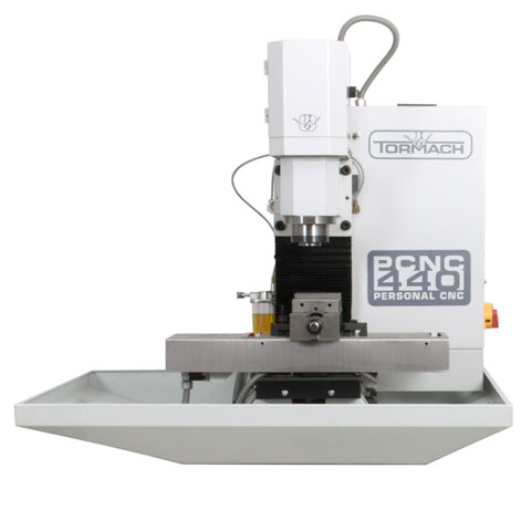

  • PCNC 440 Milling Machine & Stand
  • PathPilot® Controller and Control System
  • 10,000 RPM R8 Spindle
  • Travel: 10" x 6.25" x 10" (X, Y, Z-Axis)
  • TTS Tooling, 4" CNC Vise and Cutting Tools
Part Number: 5349
Weight: 750 lb
Price: $12,412.80
Estimated availability:
Unknown
A machine that fits all-around capability in a compact and affordable package, the PCNC 440 is perfect for anybody that wants to do real cutting but doesn’t have a lot of space. The typical footprint of the PCNC 440 is 42″ × 36″ (1067 mm x 914 mm) which allows for bench top use or mounting on the optional stand.
The PCNC 440 offers high-performance bipolar stepper motors with Leadshine micro stepping drivers. It also incorporates rolled C7 ball screws with anti-backlash double ball nuts.
It has a cast iron frame and table with hand-scraped hydrodynamic ways and tapered adjustment gibs. The way surfaces are low friction PTFE-filled Acetyl bonded sliding surfaces similar to Rulon® and Turcite®.
The PCNC 440 is rated to cut aluminum, steel, titanium, as well as plastics, composites, wood, and PCB boards.
This starter package includes the Tormach 440 PCNC Mill, Machine stand, PathPilot® controller, chip pan, standard LCD monitor, waterproof mini keyboard, jog shuttle controller, 4" CNC Vise, manual operator set (inch), cutting stool starter set, cable kit, and 1 gallon of machine way oil.
*NOTE* ADDITIONAL CHARGES WILL APPLY** - This machine ships directly from a Tormach warehouse. Freight charges and sales tax will be calculated by Tormach and will be added to your order prior to shipping. See Shipping Tab for full details.
View a comparison of the specifications for our CNC milling machines.
A question we get a lot is What software do I need to run a CNC mill?
  • Cast Iron Frame and Table
  • Dovetail Ways
  • Ball Screws
  • 10” x 6.25” x 10” Work Envelope
Table Size 18.0" x 6.3" (457 mm x 160 mm)
T-Slots 3 slots 0.394" (10.00 mm) wide
X-Axis Travel 10.0" (254 mm)
Y-Axis Travel 6.25" (158.8 mm)
Z-Axis Travel 10.0" (254 mm)
Throat 6.5" (165 mm)
Spindle Taper R8
Spindle Motor 0.67 hp (500 Watts)
Spindle Speed 300 - 10000 RPM
Maximum Feed Rate x- and Y-Axis 135 in/min (3429 mm/min)
Maximum Feed Rate Z-Axis 110 in/min (2794 mm/min)
Power Requirements 115 V 60 Hz 15 Amps
Typical System Footprint (Incl. Stand) 42" x 36" x 72" (1067 mm x 914 mm x 1829 mm)
Machine Weight 450 lbs (205 kg)
Shipping Weight 571 lbs (260 kg)
