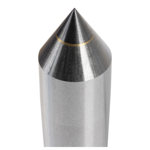

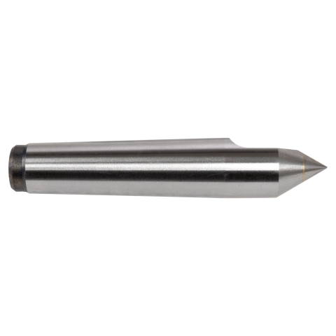

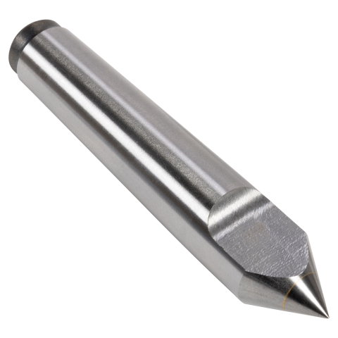

  • Made of tool steel, hardened and ground
  • Carbide tipped, 60° point
  • +/- .0002" TIR
  • 0.938" (23.825 mm) diameter
  • 4.92" (120 mm) overall length, 0.59" (14.99 mm) height
Part Number: 5472
Weight: 0.74 lb
Price: $16.95
This center is made from hardened steel and ground for accuracy. The point is a 60º included angle.
The body diameter is 0.938" and the largest diameter of the tip is 0.472". The overall length is 4.92".
