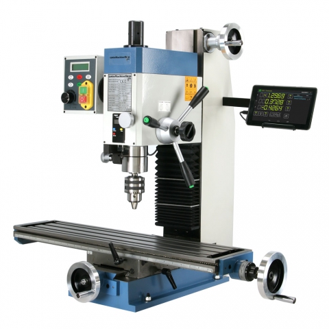

HiTorque Bench Mill, Long Table, Deluxe
  • Larger than mini mills
  • 750 watt (1 hp) brushless DC variable speed drive
  • No gears in spindle drive
  • R8 spindle and drill chuck
  • Tapping mode for reversing taps out
Part Number: 5550  (Discontinued)
Weight: 292 lb
Price: $2,663.18
The Model 5550 Deluxe HiTorque Benchtop Milling Machine has all the features of popular HiTorque Bench Mill 5500, plus:
* 3-axis digital readout (DRO) with Bluetooth and 7" tablet display
* Larger table
* Electrically interlocked spindle lock
* Machined aluminum handwheels
The LittleMachineShop.com HiTorque Bench Mill is a step up in size, rigidity, and power compared to a mini mill. This HiTorque bench top milling machine for sale provides a larger table, more travel, and more horsepower.
A 750 watt (1 hp) brushless DC motor provides abundant spindle power and tremendous low-end torque and the motor has built in forward and reverse modes easily switched from the power panel.
The 27.5" x 6.25" (700 mm x 160 mm) table provides a large work area.
The HiTorque Bench Mill incorporates a true quill and drill press-style handles for easy drilling. A button on the end of each handle reverses the spindle to make tapping easy.
The control panel includes a digital spindle speed display.
This mill is a version of the SIEG SX2.7.

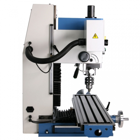

"Deluxe HiTorque Bench Mill Side View

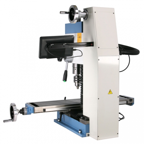

"Deluxe HiTorque Bench Mill Rear & Side View

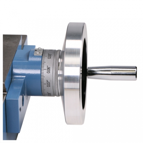

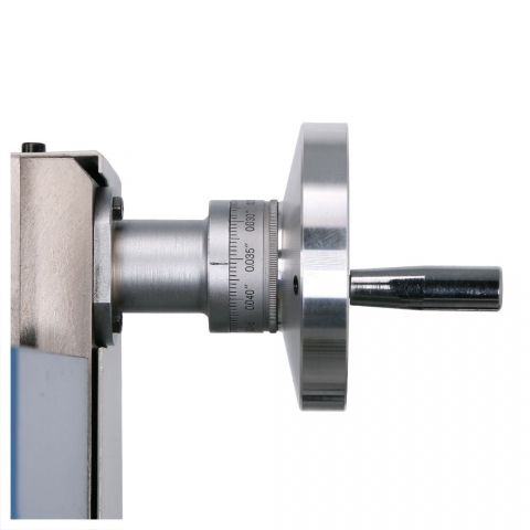

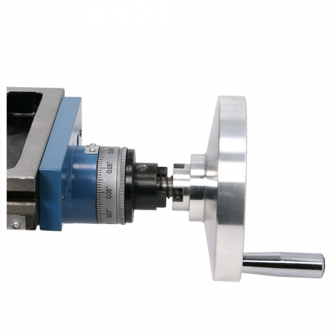

"Deluxe HiTorque Bench Mill X-Axis Chrome Hand Wheel
"Deluxe HiTorque Bench Mill Y-Axis Chrome Hand Wheel
"Deluxe HiTorque Bench Mill Z-Axis Chrome Hand Wheel
