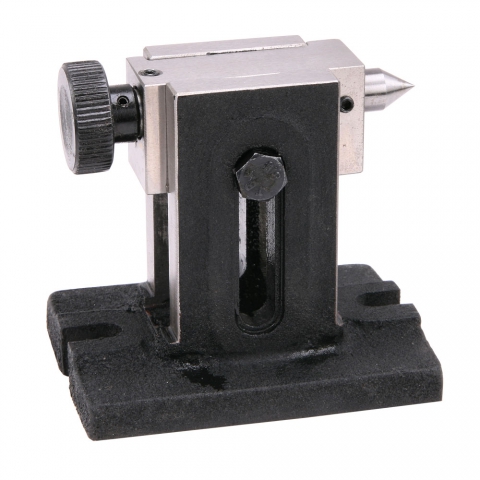

This tailstock is for the 3" and 4" H/V and Tilting rotary tables, part numbers 5601, 5602, 5603, and 5604.
This tailstock is height adjustable to ensure concentricity with the center line of the rotary table
Center Height 1.6" - 3.1" (41 mm - 80 mm)
Length 3.9" (100 mm)
Width 2.9" (74 mm)
Height 3.6" (92 mm)

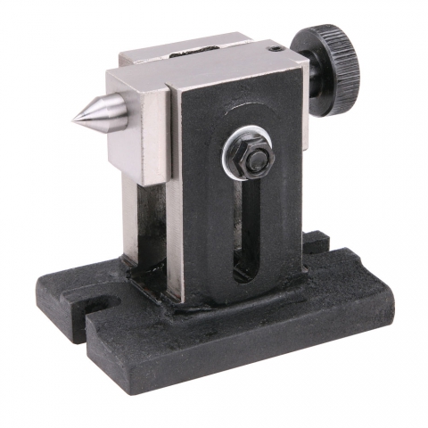

Tailstock for 3 and 4 inch Rotary Tables Reverse View
