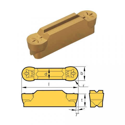

Insert, MRMN-200-M
- Cutting width (b) 0.079", Overall length (l) 0.630"
- With of body (d) is 0.059"
- Cutting edge height (t) 0.079"
- Corner radius (r) 0.039"
- Relief angle 7 degrees
MRMN-200-M grooving insert with grade BPS253-CVD coating is suitable for steel and cast steel continuous cutting, and interrupted cutting for finishing to roughing. The full radius geometry is suitable for applications that require profiling.
Insert used for the cut-off blade in product #5434.
Dimensions of MRMN-200-M Insert Cutting width (b) 0.079" Overall length (l) 0.630" With of body (d) is 0.059" Cutting edge height (t) 0.079" Corner radius (r) 0.039" Relief angle 7 degrees |
