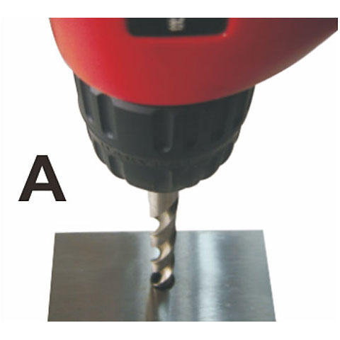

"Thread Repair Kit Drill out the old threads using the HSS twist drill that is included in the thread repair kit.

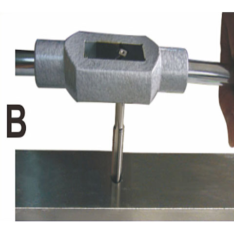

"Thread Repair Kit Tap the hole using the Screw Thread Insert (STI) tap from the kit.

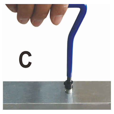

"Thread Repair Kit Install the insert using the coil driver and L Hex wrench installation tools.

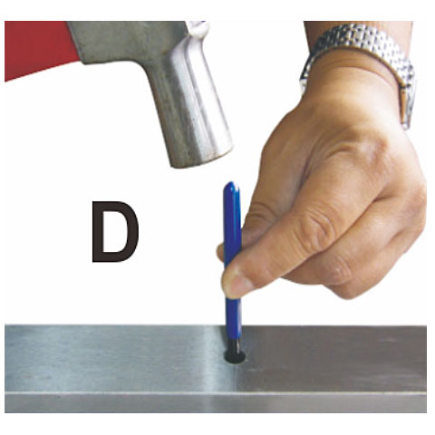

"Thread Repair Kit Remove the tang of the insert with the tang breaker (punch).
