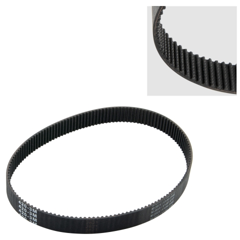

  • Timing belt, low speed, high torque
  • For speeds from 100 - 1800 RPM
  • HiTorque large bench mill
  • Fits SIEG SX3.5 bench mills
  • Belt classification: 3M-420-15
Part Number: 6013
Weight: 0.02 lb
Price: $15.95
Timing belt for the HiTorque large bench mill and SIEG SX3.5 bench mills. This is the low speed belt for spindle speeds between 100 - 1800 RPM. It allows for more torque at the lower speeds. For speeds between 280 - 5000 RPM, use the poly-v belt.
This belt is marked 3M-420 and is 15 mm wide.
Desigination 420-3M-15
Belt Length 16.5" (420 mm)
Belt Width 0.6" (15 mm)
Teeth Distance to Center 0.1" (3 mm)
Number of Teeth 140
