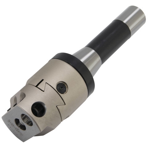

Boring Head Set, R8, Indexable with 4 Boring Bars
  • Includes boring head, R8 shank, and 4-piece indexable boring bar set
  • The boring head offsets up to 5/8", dial is graduated in 0.001"
  • Minimum bore diameter is 7/16"; Maximum boring diameter is 5.906"
  • Maximum boring depth is 2.5"
  • The included indexable boring bars come with TCMT 21.5 C6 carbide inserts for steel and alloy
Part Number: 6114
Weight: 4.38 lb
Price: $289.95
PayPal Credit

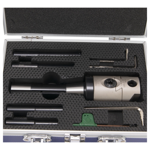

The indexable boring bar set includes 4 different length boring bars each with two requiring a 7/16" minimum bore and two requiring a 1/2" minimum bore. The bore depth ranges from 1-1/14" to 2.5". The heat treated, alloy steel shanks are held to 0.000 to -0.0005" from the nominal diameter. The included indexable boring bars come with TCMT 21.5 C6 carbide inserts for steel and alloy. 1 DIV = 0.001 which means when turning the dial by 1 division/graduation, the boring head's travel is 0.001" in radius movement and 0.002" in diameter movement. The set also comes with torx & l-shape hex wrenches and a fitted carrying case.
